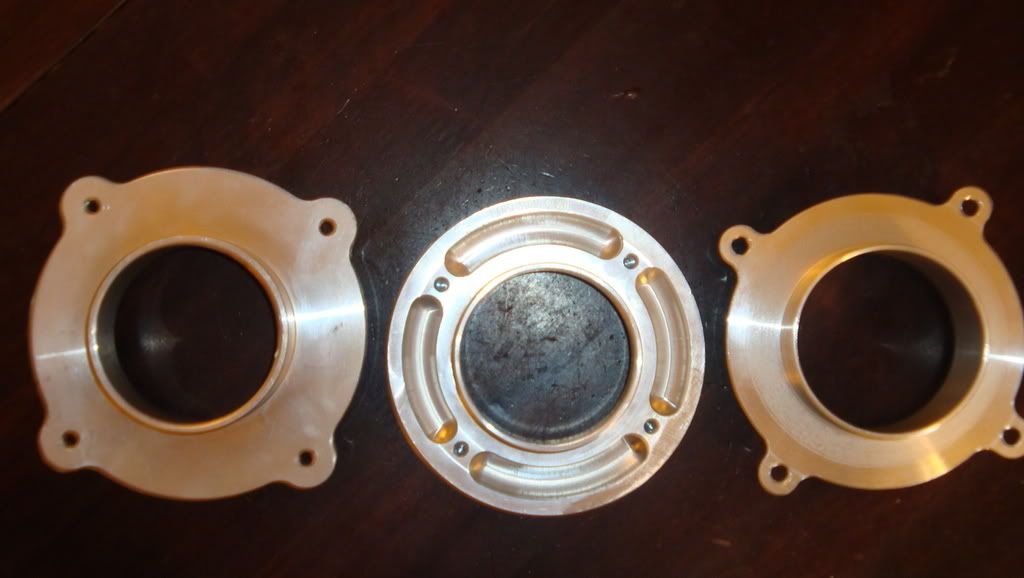

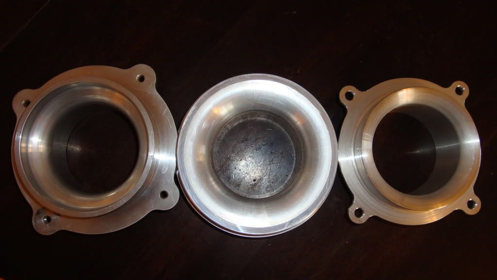

a few specs on the following... add your own please
Trinity:
Inner diameter. = 2.55 in.
tube/filter flange = SMOOTH w/lip
Filter flange O.D. = 3.85/3.80 (lip/clamp area) cone is 3.5 same as ROSSIER
Bolt pattern = 4.85 threaded
FUELATV:
tube/filter flange = knurled
Filter flange O.D. = 4.50
Bolt pattern = 3.80 threaded
ROSSIER:
Inner diameter. = 2.65 in.
tube/filter flange = ribbed (6/4)
Filter flange O.D. = 3.50
Bolt pattern = 4.85 smooth
TRINITY........................FUELATV.....................ROSSIER............

the Trinity falls behind in the looks department with a poor finish ... they dont even bother to engrave their name on it...
good info
