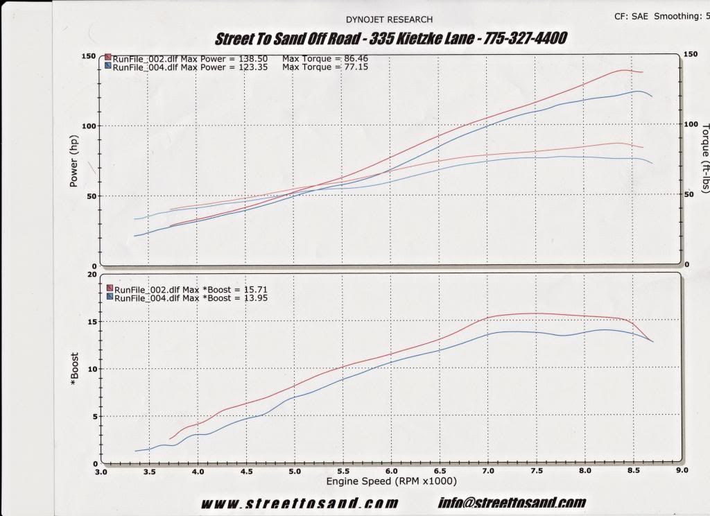

For the last 2 1/2 years we been stagnate...Lots of ideas but nothing happing in the development and testing area. 100% my fault, We need to keep this stuff in house to get it done.
One side effect of bigger cams , ported heads , over sized valves , along with a few other things with a turbo Raptor is you begin to loose torque as you gain horse power. All these mods do offer great horse power and over rev......But I wanted some of the torque back that we have with the smaller parts and mods.
This build started as a 100% stock build with one of our standard dual injector turbo kits on it. It been turbocharged for 4 years now trouble free. The owner is looking to get more power out of it.,
The bottom end is still 100% stock and never been apart , We added a turbo piston , +2 ported head , one of our D7 turbo hill shooter cams, updated the head pipe to the 2010 and up design , Bigger fuel pump with the adjustable by pass regulator.
The blue run file was done last week. Good horse power and torque , Clean boost rise. We could of left it at that , but prior testing and data told us it should make more torque.
So we moved the c/l on the exhaust lobe and added the bigger fuel pump for the red run file.
The results were quite positive. No change in with the boost controller adjustment we gained 1.76 psi in boost , 9.31 ft lbs torque and 15.15 horse power.
Not bad for a simple cam timing change.

You can see the performance gain over the prior cams tested, Both builds are the same other then the prior test Raptor has a Carrillo rod. Also note the cleanup in the boost rise little to no wave. We will discuss that soon. Lots of stuff going on.
