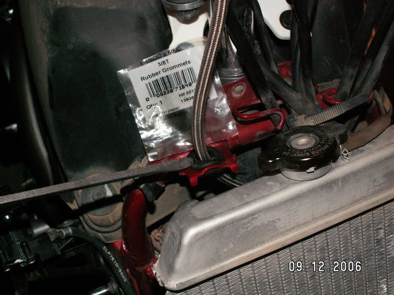

Here's something that I added when I had my '05 Raptor 660R when I upgraded to +2 a-arms and brake lines. I added a rubber gromet that I picked up at Lowes for under a buck. The idea behinds this is to protect your new brake line from rubbing or chaffing against the metal tab. Below is a pic of what I'm talking about along with the bag showing the size of gromet. Size is 1 1/8" OD x 5/8" ID.
-Johnny

Doing the brakes....good idea thanks!
